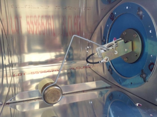

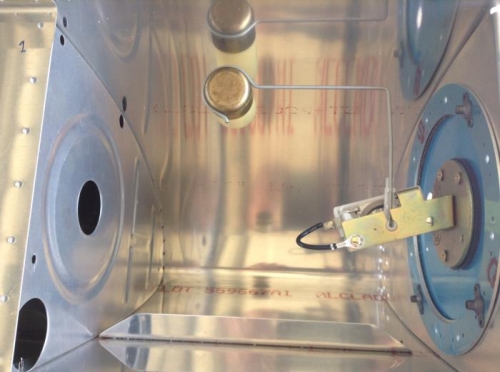

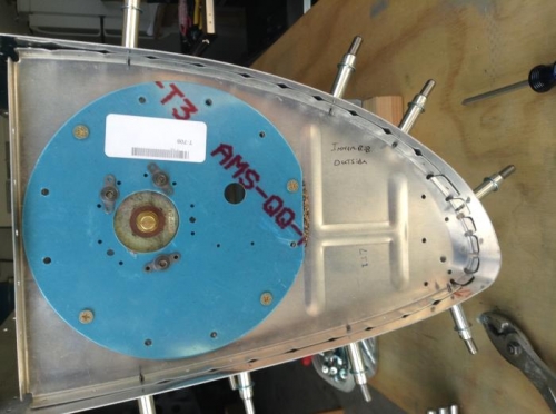

Brief Description:  assemble and fit fuel sender to t-708 access plate
Cut and bent fuel sender wire per instructions and mounted to sender. Mounted sender to access plate. Test fit plate to rib / tank assembly and adjusted float position for full and empty locations.
meets spec for no more than 1/8 inch space from top / bottom (full / empty.
Assembly mounted to tank
Full position
Full position
Empty position
