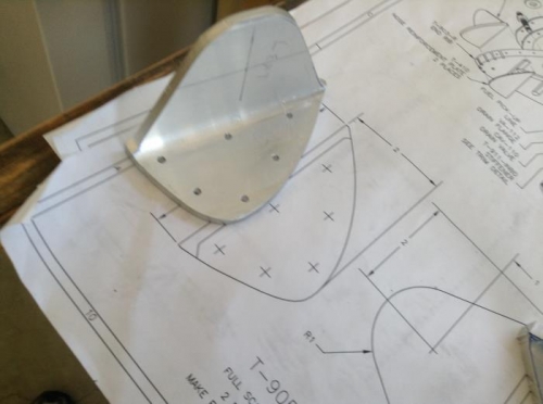

Brief Description:  Mark holes on T-905, Drill, and match drill to rib
Cut out new full scale copy of bracket markings and used drill punch to mark locations of holes. Drill out holes with #40 then #30 drill.

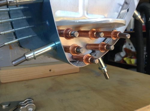

Re fit and adjusted by using scotch brite grinder. Held bracket in place by hand and drilled through tank rib.
Holes marked
Holes marked

Drilled in place to tank rib
