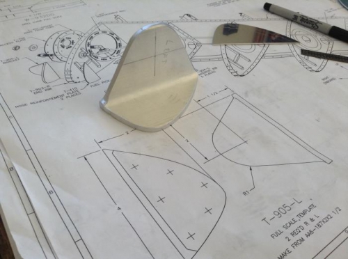

Brief Description:  Fabricate T-905 Tank Attach Angle
Dave Powell (via Tristan) found a band saw for sale in a yard sale. With his help and expertise it is now re furbished and has a new metal blade. Cuts REAL SMOOTH!!

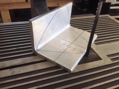

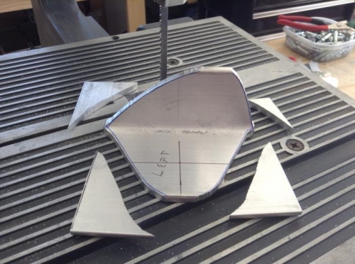

Marked aluminum (1.5 x 2 ") and am using band saw for rough outline cutting.
Used scotch brite grinder to shape and smooth bracket to fit rib. Need to be a bit more aggressive on next bracket - less grinding!
Ready to mark and drill holes
Marked and cut from whole angle
basic shape cuts
basic shape cuts
Ground and fitted to rib
