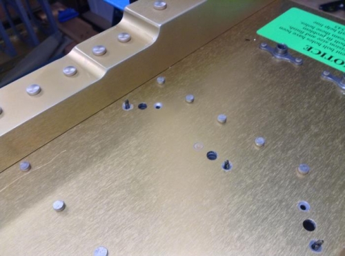

Brief Description:  Set flush rivets for spar nut plates
Need to rivet gun / bucking bar set rivets on spar nut plates.
Removed rear skin to get betting access.
Used new tungsten bucking bar - small but dense - worked well
Had to change out mushroom head to get close to spar doubler, used narrow flat extension.
All six rivets drove well, one is a 'little' high' will check tomorrow and see what I think. Its 9:45pm now.
Note - drilled out offending rivet and reset. Rivet tried to rise up again. Did light set with bucking bar, then drove head flush. Finished up driving rivet.
Cleco from under
Cleco from under
Rivets in - Spar front side
nut plates and rivets - Spar rear side.
