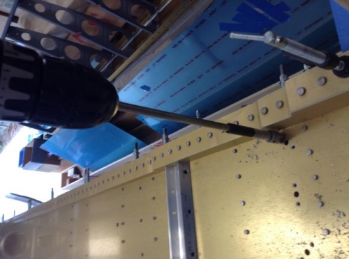

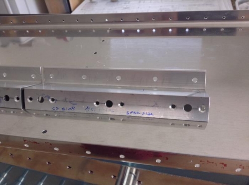

Brief Description:  CS the nut plate rivet holes in attach brackets
CS the rivet holes for the attach brackets by clamping bracket to spare piece of wood and hanging hole off to the side. Worked well. Two or three end holes had some wobble because the CS cage would not rest completely on the bracket. Hopefully it wont be too bad.
Need to CS the nut plate rivet holes on the spar but the CS tool wont get close enough to sides for two holes.
Will need to figure out how to do by 'hand'. Used extension of deburring tool and CS bit. Fit in drill and produced pretty good CSs.
