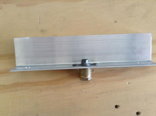

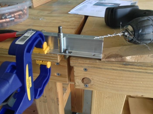

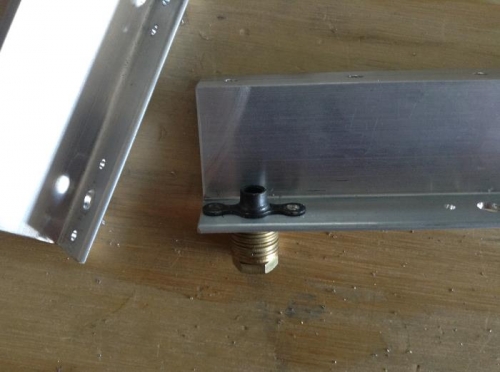

Brief Description:  Drill, attach K1000-3 nut plate to attach bracket
Attached K1000-3 nut plate to each hole in 6 of the attach brackets using a screw and nut plate with a bunch of washers. No cleco would hold things in place (too big or too small). Drilled each hole / nut plate one hole at a time.
Ready to countersink for rivets..
