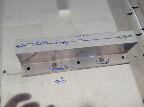

Brief Description:  Remove attach brackets and baffle from tank
Double checked each attach bracket markings and baffle markings (need to get everything back in the same order!).

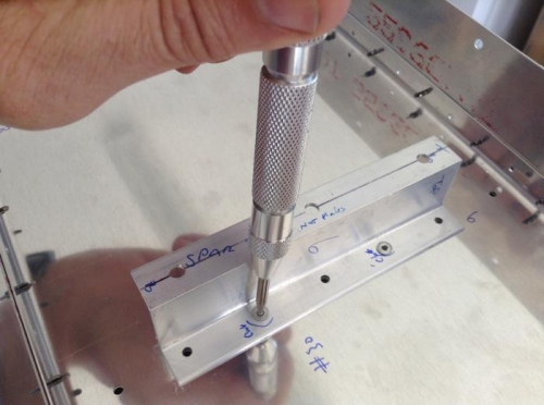

Drilled out temp pop rivets and removed attach brackets. Used punch to partially drive out center pin. Then drilled off top with #30 drill bit. Finally used #30 reamer to enlarge pop riveted holes.
Removed baffle from assembly. Deburred the holes on the inside of the tank skin where baffle attaches. Deburred the tank / rib attach holes
Deburred attach brackets.
Marked
Marked
Punch out center pin
