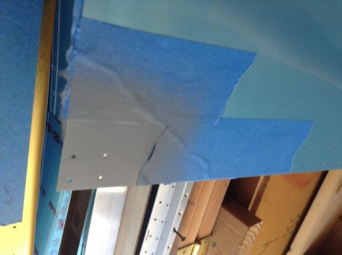

Since I was going to be fitting the tank assembly I wanted to check the fit of the wing skins to tank skins.
Beveled corner of inboard skins, per directions, so that the overlap was very close to the same thickness as the tank skin.
Took a lot of grinding / filing to get enough material removed. Got close so I kept from going and deeper, wanted to leave as much material as possible. Cleaned up, taped off, and primed the beveled part of the skins.
