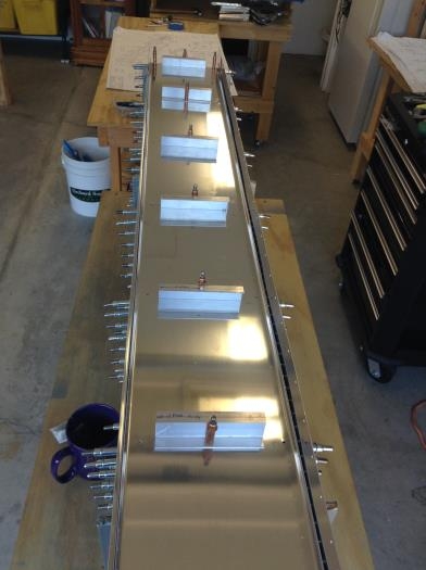

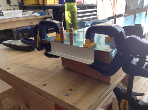

Brief Description:  Cleco attach brackets to baffle and drill out
Clecoed the attach brackets to the baffle and drilled out all holes.
Removed brackets and deburred holes and edges.
reassembled and attached baffle assembly to tank assembly.
Used pulled rivets to temporary attach brackets to tank assembly (through bracket, through baffle, through rib.)
Needed to grind down rivet puller to be able to get close enough to pull rivets.
