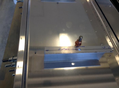

Brief Description:  Drill first holes in attach brackets

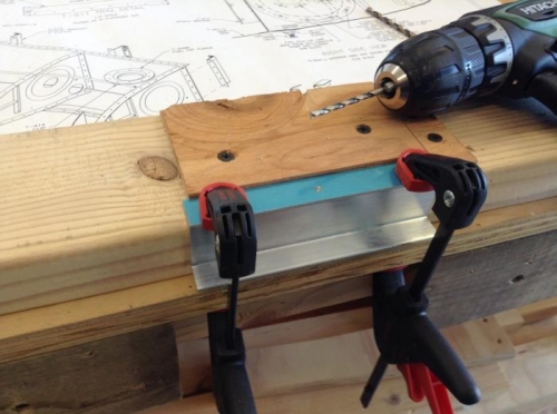

Created / made a guide from 2x4 and small scraps of wood. Created a right angle side that attach bracket and W-932DG (drill Guide) nested into and provided a clamping surface.
Guide worked well and only had to use one drill guide (4 are supplied ?? maybe assume a lot of wear??)
Drilled first hole in both side.
marked center line on both sides of bracket.
Enlarged the spar side hole of each bracket to 3/16.
