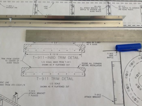

Brief Description:  Fabricate T-911 stiffeners

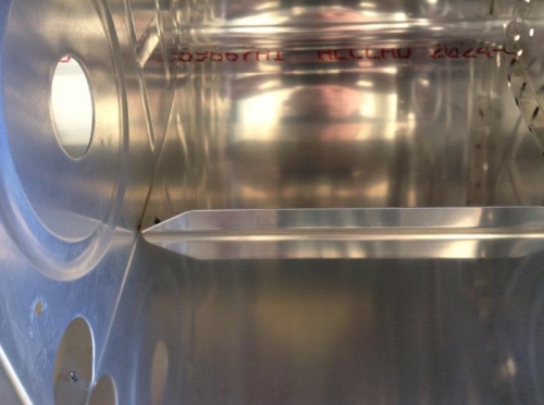

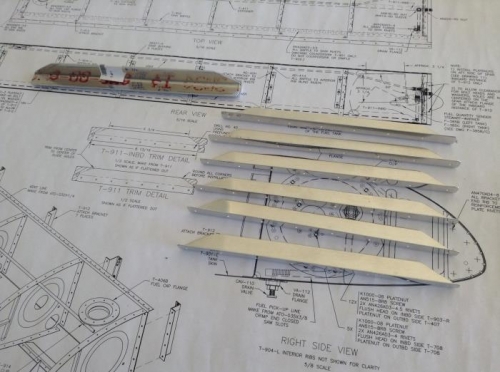

Marked and cut T-911 stiffeners. Inboard stiffener seems to have a right and left option. Cut both sets and it appears that one will fit right fuel tank. Left one would have to be installed facing the opposite way. Per plans and other web site pictures the rivet holes 'face' forward toward the leading edge. Flange is facing rear.
Will call Vans on Monday and verify. May have to re order t-911
Clecoed other 5 stiffeners. Final drilled them out using reamer.
