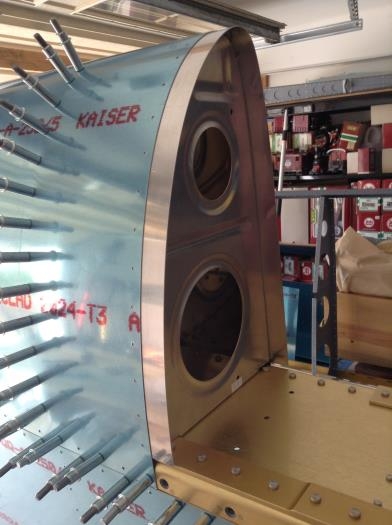

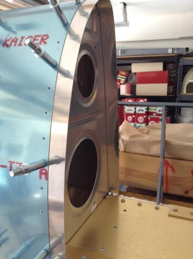

Brief Description:  Fit leading edge to wing, fabricate W919 doubler s
Mounted left leading edge to wing. Had to double check wing alignment because skin holes to spar holes were not fitting well. Verified alignment and pulled skin into position.
Fabricated doubler strip, fit to rib / skin.
Drilled out all leading edge skin to rib / spar holes.
drilled out spar to rib holes (#30).
Drilled out four holes in inboard ribs to match holes in spar - narrower spacing due to doubler plates.
Fitted and ready to drill
