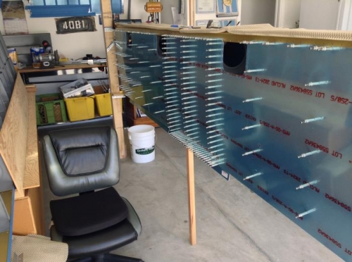

Brief Description:  Drill out holes in bottom skins
Working "down and out" drilling out holes. Drill down rib then across top and bottom, work outward to each edge. Using reamer on all holes except doubler ribs.
MAJOR MILESTONE! Able to move spar packing crate out of garage!! Gives more room to work on each side of wing.
some rib tip / skin / rear spar were real tricky. Couple of them bent back and had to use long wood dowel to hold in place.
1pm -6:40
Wing spar box empty! Can be moved
Drilling and Clecoing
Done!
