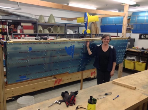

Jeanine held J-stringer (with a small metal ruler between the rib and stringer- to keep small distance between metals) while I drilled holes that attach to ribs. Will drill out remaining holes tomorrow.

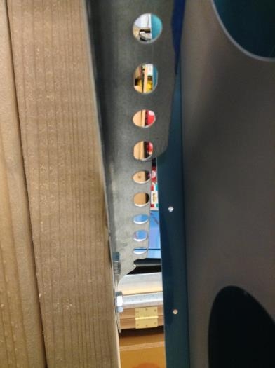

Attached the inboard bottom skin, then the outboard bottom skin. When We got to the outboard tip the skin couldn't get past the metal angle brace.
Had to remove brace (fortunately it was the support and not the main angle!). Cut out / cut back angle, deburred and replaced. Fits nicely.

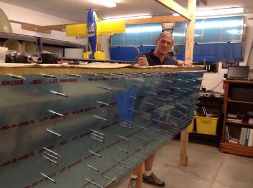

Clecoed every fourth hole. All went in well only minor adjustments for a few by reaching in and moving rib with hand.
Cut back supporting angle
Stringer in and skins on
BIG help with another set of hands!
