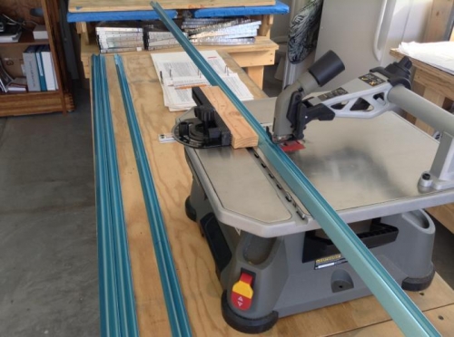

Brief Description:  Make J Stringers - pulled out bottom skins
J stringers cut to 80 3/4 " and 40 1/4 ". Made both sets and deburred.
Marked blue line 3/8" from non bent edge on all 4 pieces.
Next step clamp and drill to upper skin.
Set J stringer in place and tried drilling first holes. Not lining up well so waiting until Jeanine (second set of hands) to drill remaining.
Pulled out bottom skins and removed tape and verified orientation. Ready to attach.
