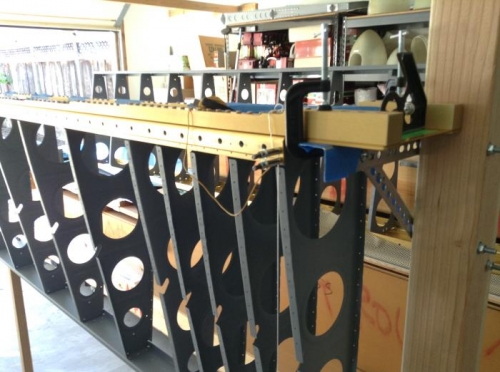

Had to buy new 4x4 posts and rebuild the wing frame. Original posts had warped / twisted and could not be used with brackets to hold up wing. One post had a 15- 20 degree twist.
Turns out that the 133" measurement shown on plans is a bit too wide - wing wont hang with brackets close enough to clamp rear (lower) wing spar. Took a lot of doing but I did get a straight fit.

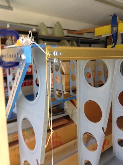

Used two plumb bobs to verify that there was no twist to the wing.
Cut a length of 1.5x1.5 to brace under the middle of the wing. Cut long and sanded down ends until string was straight across top of all holes.
Consumed and entire week.
Finally hung with plumb lines and brace

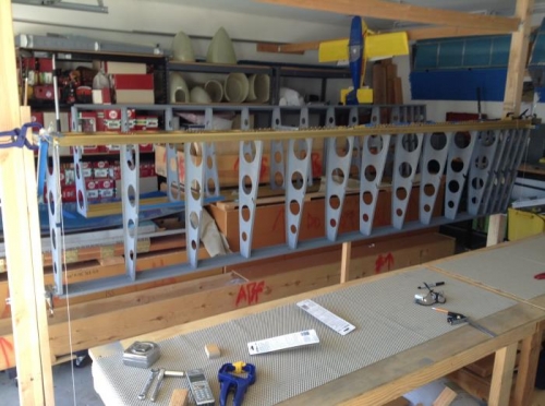

Clamped and level
Clamped and level
running string to level wing
