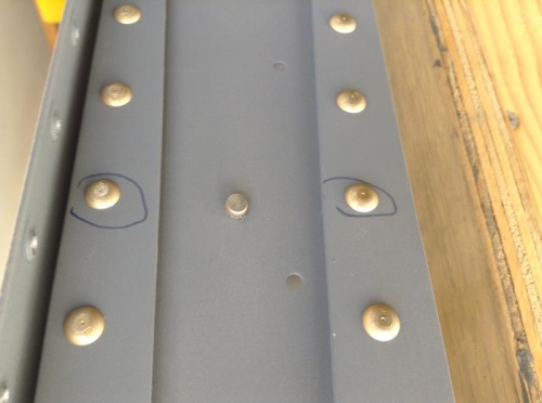

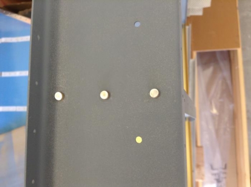

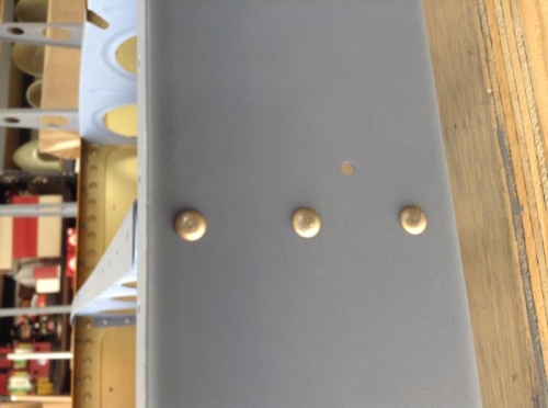

Clecoed rear spar and verified position - Jeanine helped check.
Squeezed all rivets except end countersunk 3 and noticed that all the 470AD rivets had been installed backward. Manufactured head was supposed to go on the inside (Rib Flange Side).
Need to check with Tech Councilor or Vans to see how big a problem this is - hopefully not. Really hoping its cosmetic and not a structural concern.

Middle rivet is correct - shop head out
Installed with manufactured head out
This is what it should look like
