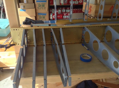

Clecoing ribs to front and rear spars.
Touching up front side of rear spar - some areas of primer did not stick.
Ribs attached to front spar. Going to rivet front before clecoing rear spar to ribs - should be slightly easier to get to rivets.
Was able to get three ribs, large spacing, in by my self. Tried the close spacing but after one rivet I could see that is was not a good idea.

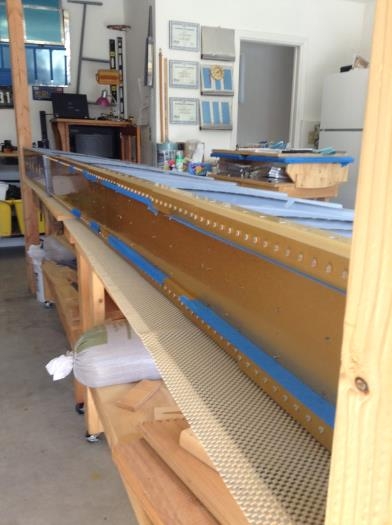

Main spar protected
Main spar protected

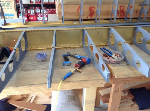

Leaving off rear spar for more room to rivet
Works much better!
Works much better!
