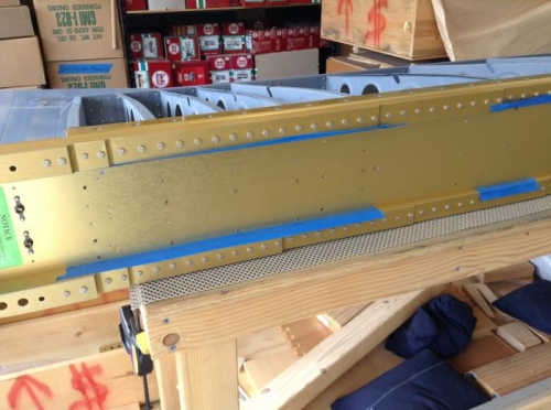

Brief Description:  Set up and drive rivets on front LW spar
Turned wing over, clamped to tables, protected with tape, and verified rivet sizes.
Starting with rivet gun - been a while...
After some practice rivets, on scrap, and re-evaluating rivet / rib / spar positions it seems unwise to set these by myself. Not a good way to get consistent pressure and a perpendicular angle on the rivet head.
Set 20 rivets - 4 ribs. Jeanine held the bucking bar. MUCH easier!
Tape to protect main spar
