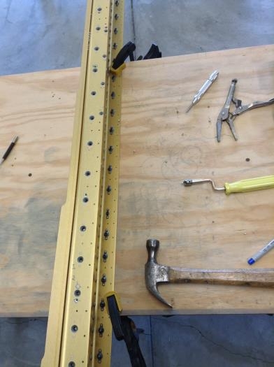

Brief Description:  Inspected and replaced tall rivets on Left Spar

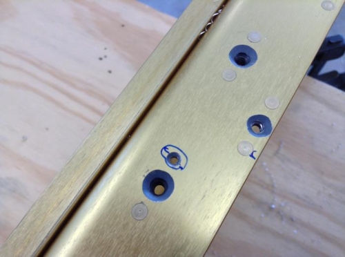

Several rivets rise up too tall / edge above hole (flush rivets) on nut plates.
It appears that the countersinking was not 'quite' deep enough and when primer is applied it makes the rivets not 'quite' flush. Replacing several on both flanges of the spar.

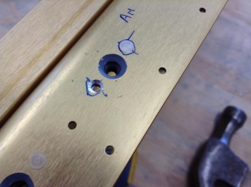

drilled out, re counter sink, cleaned, primed, and re riveted 9 rivets.
Drilling and countersink
