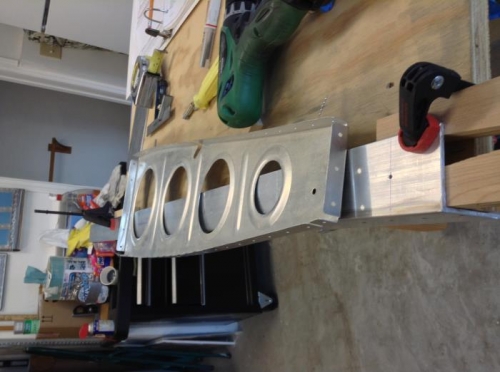

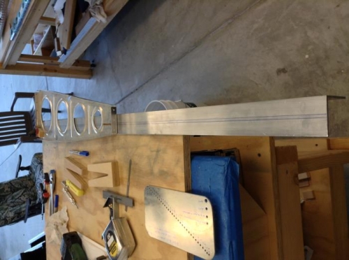

Brief Description:  Make Aileron / Flap alignment tool
Used angle aluminum. Used undrilled rib alignment holes to mark angle, drilled out to -3 (#12 ream).
Installed -3 bolts and using straight edge marked reference lines, the width of the bolts for the length of the angle aluminum.
