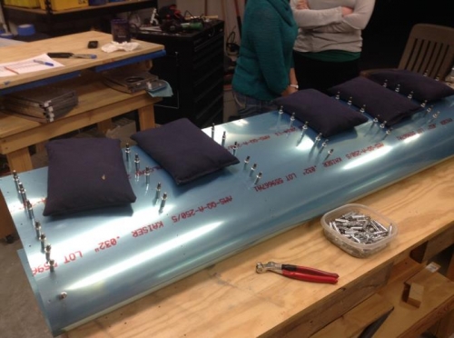

Brief Description:  Set up to test fit right tank ribs

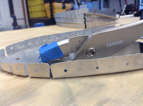

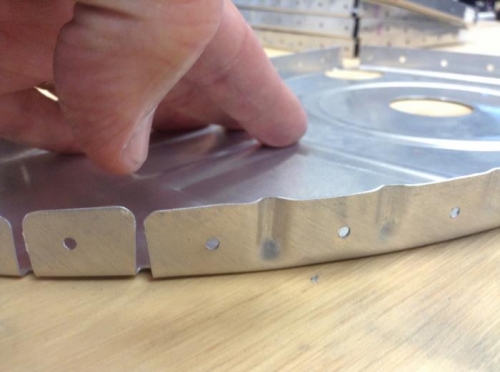

Pulled out right tank skin. Re- flute ribs for test fit. Learned on left tank ribs that the last fluting position needs a GOOD squeeze. Lining up last three holes is hard. Last two are on their own web cut outs so they float a bit better. #3 is harder.
Re- fluted each rib.
Test fit. Some will need adjustment.
Holes not well aligned
GOOD squeeze and they line up better
Test fitting
Test fitting
