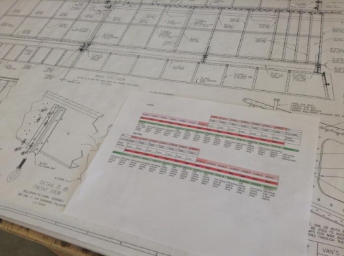

Brief Description:  Re Start wing rib process - read and document
Created document and spread sheet.
Doc - what needs to be done by rib number / type
Spreadsheet - visual aid to correctly position ribs by number and orientation (R vs L).
Plans "Show" left wing and rib placement by number and orientation. Right wing reverses most orientations (R facing flange vs L facing flange). Created, color coded, checked, and printed spreadsheet as a one page quick reference. STILL need to constantly verify and double check plans vs build manual.
