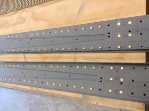

Verified and marked 907 B C D E for rivets. Marked holes not to be riveted. Marked specific rivet numbers next to holes that need to be riveted. Clecoed doublers to both rear spars.
Beginning with 907 B / C, AN407AD 4-6 rivets
Completed riveting 907 B and C to 907 Rear spars.
Had to drill out one flush rivet.
Marked and clecoed
Marked and clecoed
All Riveted
All Riveted
