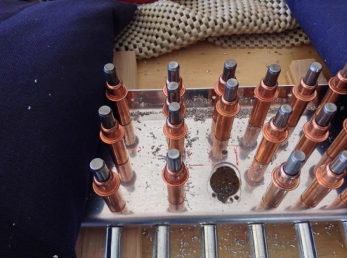

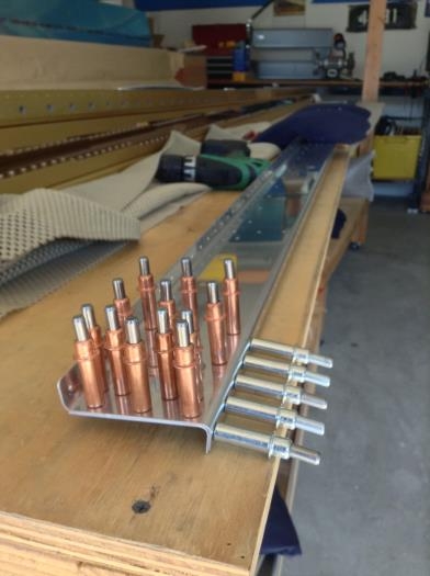

Brief Description:  Drill out match holes in left rear spar
Continue match drilling holes in W907 D & E to W 907 A rear spar.
All holes drilled. Aileron hole small holes drilled, then unibit drill to clear out as much as possible, and then had to file to final shape. Cleaned up with scotch brite pad.
Drilled and clecoed
Drilled and clecoed
