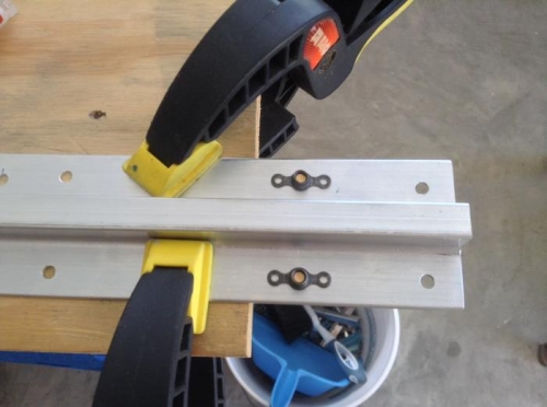

Continue with Left Spar Tie Down
Drill out nut plate rivet holes
Countersink nut plate rivet holes, aft side of tie down.

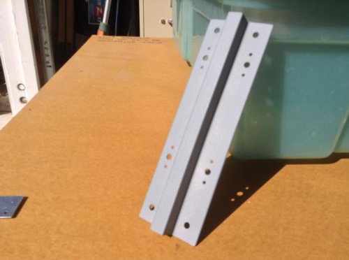

Prep and prime tie down and holes in spar. Letting primer dry for 1 hr. min.
