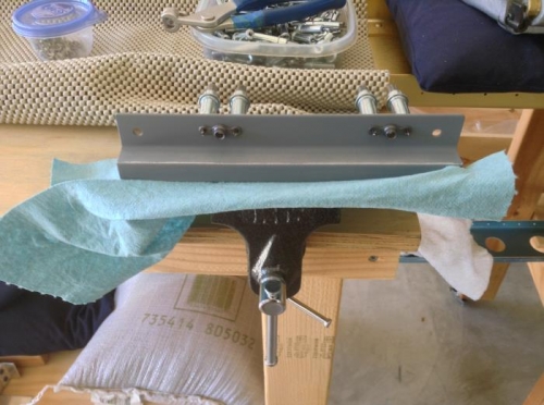

Riveting nut plates to AEX by holding AEX in vise.
Torqued AN3 bolt / AN 365 nut to 20-25 in lbs.

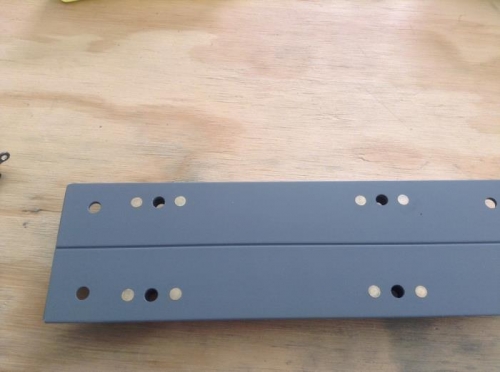

W823PP (Bell Crank brackets) needed bold holes cleaned up with #12 reamer. Brackets are powder coated steel so holes were primed with cotton swap dipped in primer.
Drilling match hole in left tie down AEX. Fit to spar and drill other three holes. Drilled out 4 bell crank bracket holes.
Installed bell crank brackets and torqued to 25 inch lbs.
Riveting nut plates to tie down
Flush on back side of tie down
