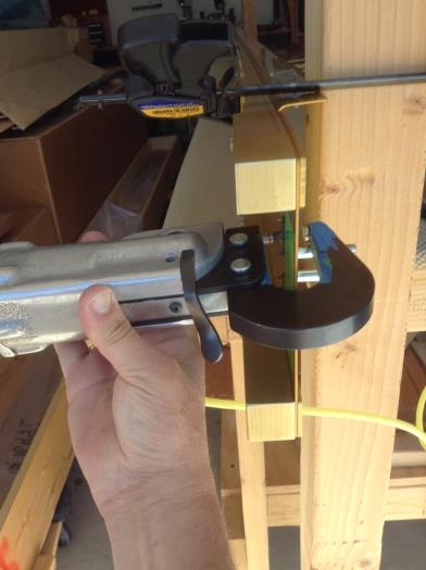

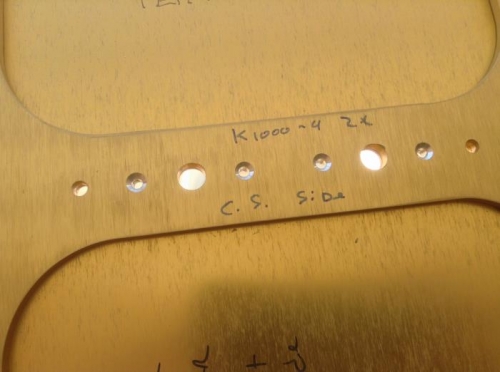

Brief Description:  Drill out, countersink, prime, and install K1000-4
Double checked instructions, drawings, and parts to install two K1000-4 nut plates to each spar.
Countersink side is the aft side of the spar. Reaming out holes with #40 reamer.
Good countersinks, good priming, good squeezed rivets.
Countersunk, ready to prime
Clamped, and squeezing
Good Clean Rivets / nut plates
