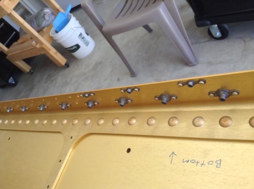

Brief Description:  Prep, rivet large nut plates to bottom right spar
Cleaned up around 5 re-countersunk / primed rivet holes. Clean and prime with Q tip / cotton swabs. let dry overnight -thinks this makes it harder / better bond. (??) gently removed excess primer around holes with metal scraper. Cleaned up nicely.
30 min to clean up holes and rivet 31 rivets. All Rivets good. Nice and flush!
Had to touchup countersink depth on all 24 small holes and 1 large rivet hole. All other 30, out of 31, large rivet holes were fine and rivets went in smooth.
All nut plates attached to both spars.
86 total rivets, no drill outs!

All nut plates complete
