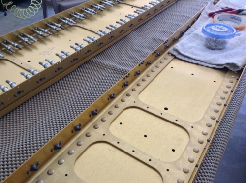

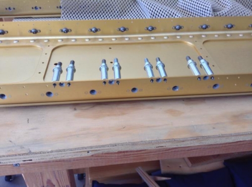

Brief Description:  Rivet #6 and #8 nut plates to left bottom spar
Drilled out rivet from other day two times. Finally figured out process / method to reliably squeeze flush rivets. Used rivet tape to hold rivet then partial squeeze and check flush / fit, then finish squeeze slowly with firm pressure against flush head.
Completed left spar nut plates and set up to do right spar.
# 6 nut plates ready to rivet
Rivet tape works best to hold rivet
