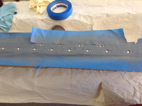

clean and prime nut plate countersinks
Used pivot driver with scotch brite swatch to rough up countersink holes.
Taped off, and primed.
Needed to touch up a couple of holes.
Used more tape than other side
left smaller outlines to clean
Small touch up needed
