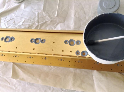

Brief Description:  Clean up holes and prime bottom of left spar

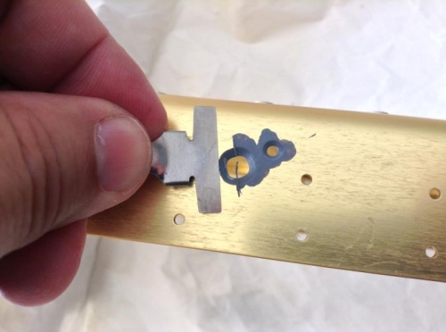

Re dressed / countersink the rivet holes - they seemed a little small. About 1/2 needed touching up.
Cleaned up holes with back end of a drill bit and scotch brite, twisting. Used acetone and Q Tips to clean holes.
Used Q tip and spray paint a cup to prime holes. Applied two coats.
Priming with a Q Tip

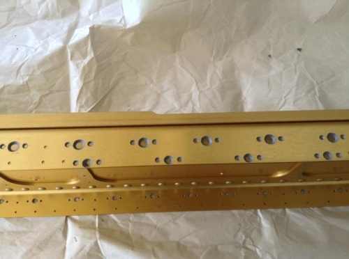

Cleaning up extra
Cleaning up extra
Cleaned up / primed
Cleaned up / primed
