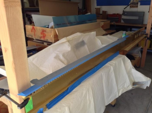

Clean spar metal for priming
Need to remove all grease / oil and then clean with acetone to prep for priming.
Cleaned with Simple Green, then wiped down with acetone.

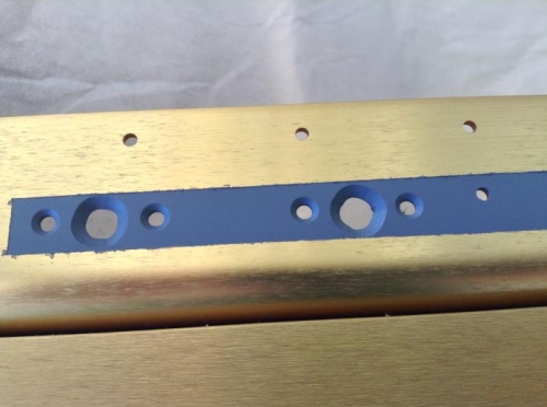

Masked off area with Blue tape and primed with spray primer
Taped, covers, and primed

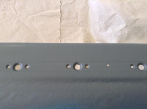

Primed area with tape
Primed area with tape removed
