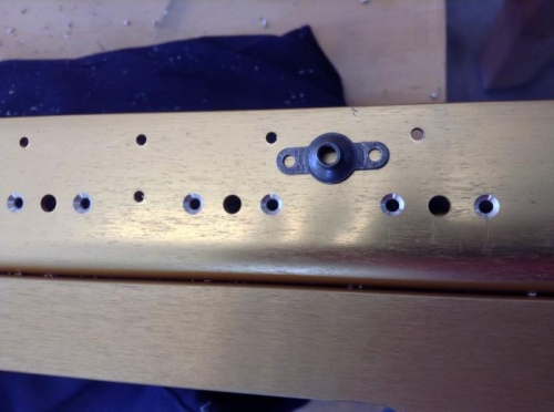

Spent ~ hour verifying instructions, sizes of drill bits (tried #41 drill to keep hole smaller - didn't work because countersink bit is #40)
Determined that nut plate rivet holes are undersized and need to be drilled out / reamed to #40.
nut plates are attached using AN 426 AD 3-4 rivets. Going to use reamer and countersink with #40 bit.
Drilled out / countersunk first 31 nut plates, 62 holes. Looks good, clean, smooth.
#8 screw holes need to be drilled out to #19

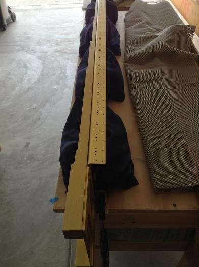

Spar clamped and sandbaged
Drilled / countersunk holes
