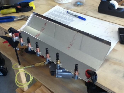

Also need to be careful and use plenty of clamps / support when drilling holes in hinge material. Hinge material is very flexible and bends / bows easily. Perhaps drilling into a scrap piece of wood with the hinge / skin clamped to it would be even better.
Hinge clamped to lid ready to drill

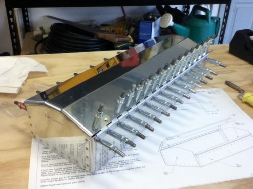

All holes drilled in hinge / box assembly

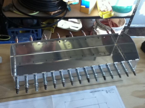

Sides riveted and all hinge holes drilled and dimpled
