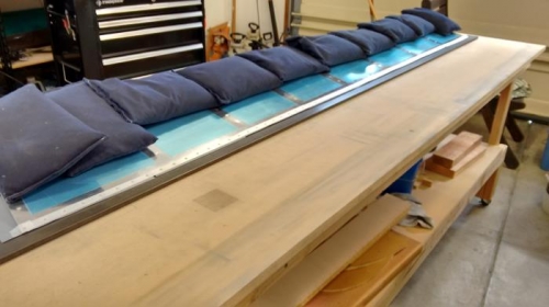

Brief Description:  Install rivets in right flap trailing edge
Clecoed trailing edge wedge in place

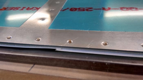

Pre squeezed rivets for snug fit, and pre set some with hand squeezer to keep everything in place.
Remove clecos and install pre squeezed rivets.

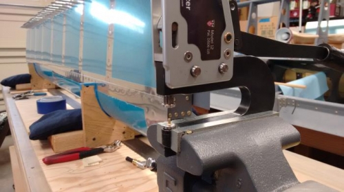

Back rivet 1/2 way with bottom side up
Turn over and finish rivets with mushroom head (against long bucking bar)
Pre squeezing rivets for tighter fit
Bottom side ready to start back riveting
Top side for finish riveting
