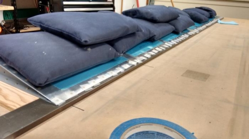

Brief Description:  Trailing edge rivets
Drilled out last three rivets from last night. All rivets popped out when slightly stressed Not sure that 3- 3 rivets are what's needed. Going to try 3-3.5 and maybe some oops rivets if holes seem over large.
Pre squeezed each rivet and taped in place (fatten up shaft for tight fit through all holes.

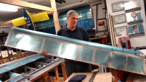

Left flap done!
Pre squeezing rivets
Ready to back rivet
Ready to back rivet
Left flap done!
Left flap done!
