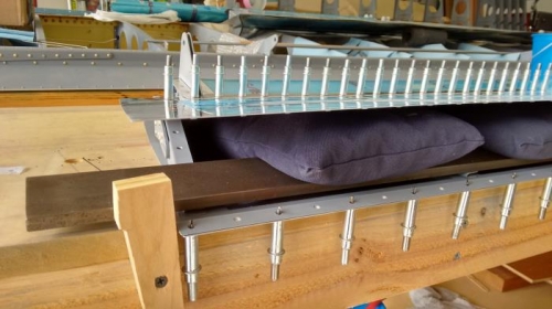

Brief Description:  Attach and rivet bottom skin to spar
Weight down flap with 8' bucking bar, stabilize trailing edge with wedge, and place sandbags on skins between ribs to keep everything flat.
Rivet top skin / LE skins to spar by reaching into / under with bucking bar.
All in!
Weighted and ready to rivet
First section done
First section done
70 rivets in
70 rivets in
