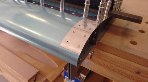

Brief Description:  Attach top skin and nose skins. Rivet nose skins o

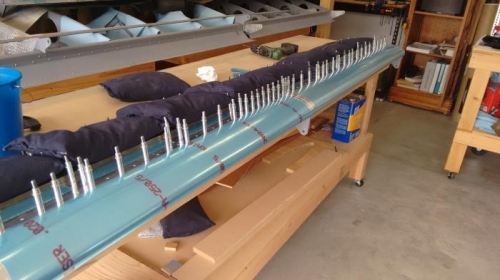

Attached top skin and weighted everything down to keep ribs FLAT on bench.
Attached nose skins. They go on MUCH easier after fitting and drilling and dimpling.
Drill out holes (inner holes where squeezer cannot reach) with 7/64s drill and pop rivet 319-BS rivets.
Squeezed end 426AD 3-3.5 rivets. One drill out back side slipped off rivet tail, split rivet
Weighted down and ready to attach nose skins

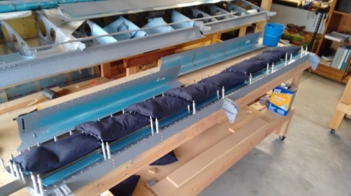

Pop rivets and squeezed rivets on end
Complete LE done
Complete LE done
