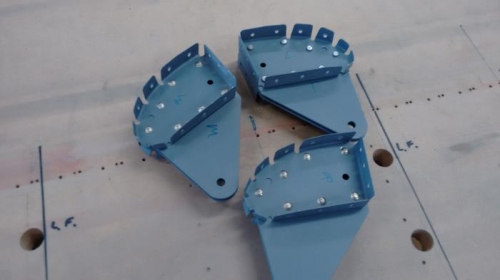

Rivet nose rib assemblies

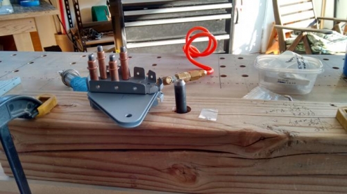

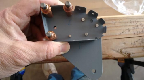

Clecoed and used back rivet block to set rivets.
Over drove two rivets and had to drill out.
BIG rivets 4-8 -lots of drilling.
Back rivet block set up
Holding for riveting with back rivet bit
All three done
