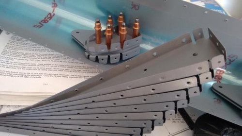

Dimpled ribs with squeezer. Did last two holes top and bottom with rivet gun and back rivet plate (drilled out/CS for dimpling).

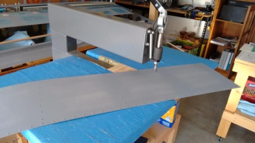

Did skins with squeezer except middle three holes. Used DRDT-2 and hand dimpled the holes (each rib each skin).
