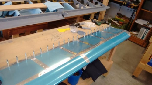

Drill out and pop rivet bottom skin

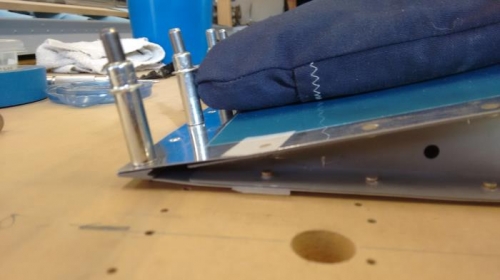

Flap flat on the table bottom skin up. Weighted and trailing edge wedge clecoed in place.

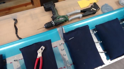

Drill out interior holes for MK-319-BS pop rivets. Exterior rib will use AN 426 3-3.5 flush rivets.
Drill and pop rivet center out
Back riveted last rivet
Done
