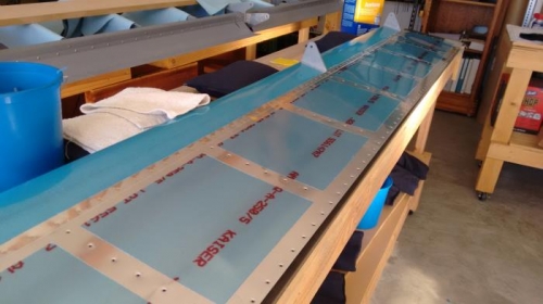

Brief Description:  Rivet nose skin/ bottom skin to spar

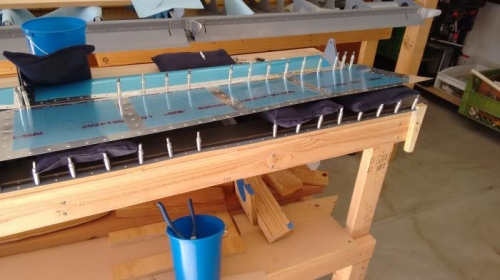

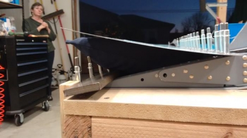

Weighted top skin with sand bags, and put long Steele back riveting bar on top of ends of ribs to keep everything flat. It seems that the nose skins are causing some twist / pulling spar.
Reaching inside with bucking bar and flush riveting from the top.
Back rivet bar helping hold things down
Reaching in and under to buck rivets
