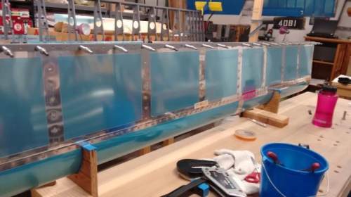

Brief Description:  Rivet top skin to ribs
Using both trailing edge wedges to clamp the trailing edge and keep it aligned / straight.
Mostly a feel good gesture but it looks nicer. Maybe (?) holding edges of ribs better aligned?
All ribs riveted to skin. Last hole of each rib will need to be back riveted. Too tight.
