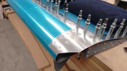

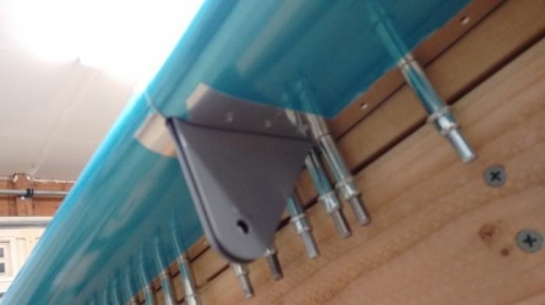

Brief Description:  Drill out and pop rivet nose skins
drill out holes with 7/64th drill but had to wiggle it around to get a big enough hole.
Used trick of slightly bending the shaft of the pop rivet to get the flush pop rivet to finish flat against the skin when pulling rivet close to other parts
