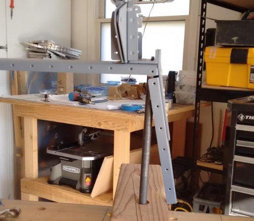

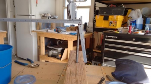

Brief Description:  Rivet inside nose rib and attach angles
Rivet inside nose rib to spar
Outside to inside
(3) 4-4, (3) 4-6, (2) 4-6, (3) 4-7
Attach angle riveting closest to radius required using the back riveting block - hold manufactured head in place with rivet driver (held in place by block point up) and then using back rivet head to smash rivet.
Inverted rivet block
angled rivet driver to reach in
