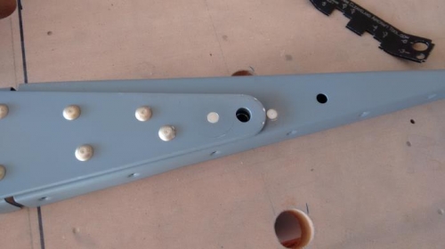

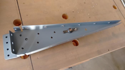

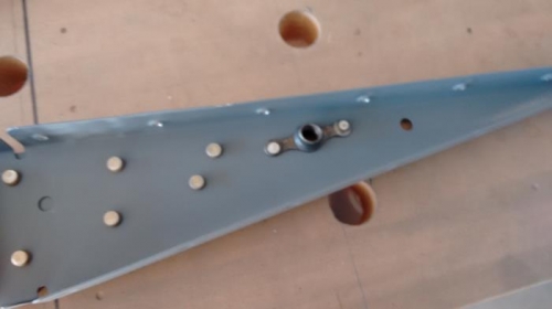

Dimple / CS and rivet nut plate to main rib
Dimpled rib and CS 906B. Dimpled one hole of the nut plate.
clecoed to rib and back riveted nut plate to rib.
Riveted 906 B to rib then back riveted second nut plate flush rivet.
Check fit and rivet first flush rivet
top view all rivets in
Bottom view all rivets in.
