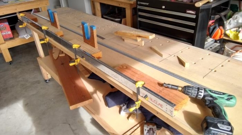

Clamped spar to table, CS with small diameter CS tool.

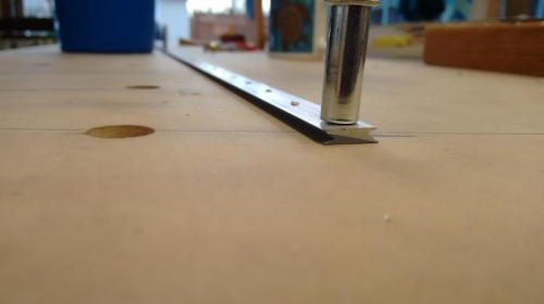

Clecoed wedge on top of other wedge to table, did one side then turned over and did the other.
Went really well. Made nice flat surface to counter sink.
Clamped 2x4 to table with spar flange between them
Clecoed wedges together
