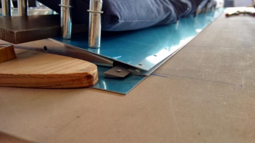

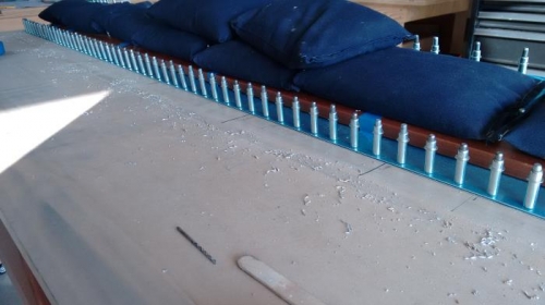

Drill trailing edge and cleco to table

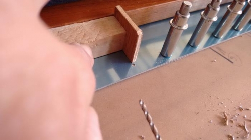

installed double wedge (one behind the other) for proper spacing.
Drilled from center out and clecoed to work bench.
Used drill guide for proper angle
Proper spacing using other wedge
Drill guide
All drilled and clecoed
