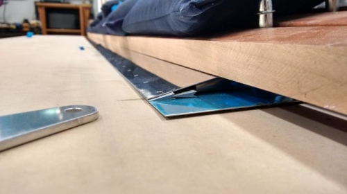

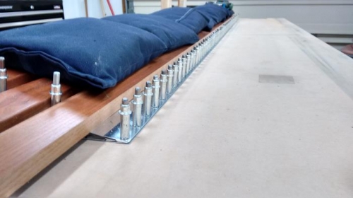

Drilled and clecoed trailing edge to bench. Trailing edge wedge used as spacer for wedge being drilled.
NEED TO NOT RIVET IN TRAILING EDGE UNTIL RIGHT FLAP TRAILING EDGE IS DRILLED

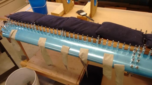

Drilled out top nose skin holes.
Wedge used as space
Wedge used as space
Trailing edge drilled and clecoed to bench
Top nose skin holes drilled and reamed
